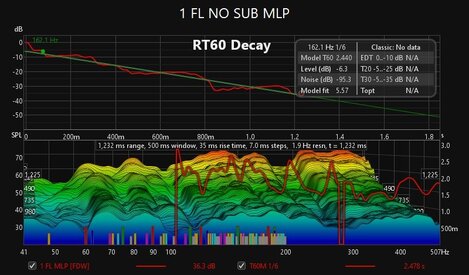

I have used Obsessive Compulsive Audiophile excellent tutorial to calibrate my home cinema. My cinema sounds great. but the graphs look horrible.
I do not know how to evaluate the graphs, but from Audioholic's video How to Measure Good Room Acoustics my RT60 decay graphs do not look good.

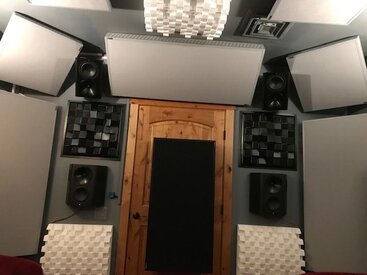

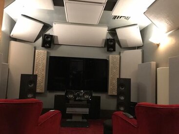

My room consists of RealTraps "MondoTrap in each of the four wall-to-wall corners" and "the top of each wall where it meets the ceiling",
GIK Acoustics FreeStand Bass Traps (4" x 24″ x 60”) on the side walls and
Sonitus Bigfuser II Acoustical Diffuser are on the rear wall and rear ceiling.
The side wall treatments placements are based on page 5 Sonitus Standard 150 asymmetrical plan
There are no spaces between panels and not placed 24 inches above the floor.
Room dimensions and speaker placements are provided in the Room Simulation tab.

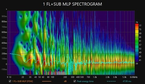

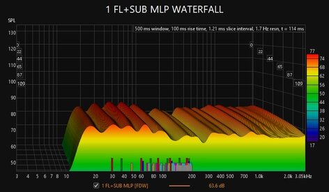

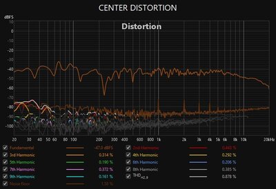

Look at the Distortion tab; all of your measurements show extreme THD. Are you sure your mic is good?
Something has gone horribly wrong with those measurements.

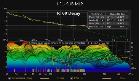

Filtered Impulse:

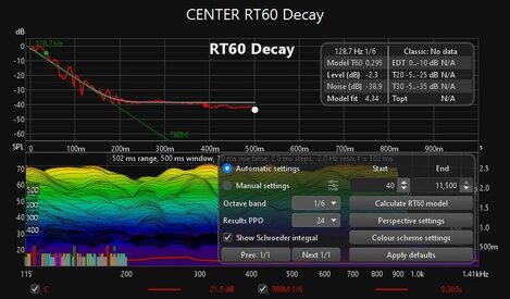

RT60 (note the scale on the left is set to 3.5 seconds):
It's almost as if there was some additional processing or monitoring going on during the measurement. Also, you had a Frequency Dependent Window set for these. You don't need that when measuring the room response as it's going to limit the lowest frequency. Turn that off and double check your signal chain before measuring again.

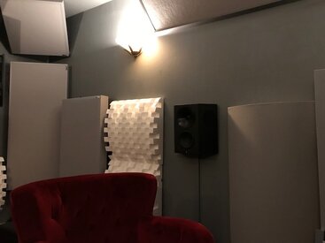

Your room seems small and if it is, you’re sitting too close to your diffusers. Try removing “all” of your diffusers, leaving only your bass absorbers and retest. Room otherwise looks good though.

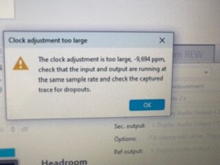

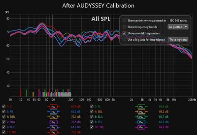

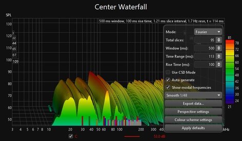

I'm now getting the Clock adjustment too large and High Measurement Distortion windows when measuring my speakers.:gah:
The clock adjustment error may be an indication that REW is having an issue detecting the timing chirps at the start and end of the sweep. This could also indicate that there is some latency issue in the system itself. Increasing the ASIO buffer to the maximum value might solve this.

That is an option—as is using a shorter HDMI cable. Another thing to try to fix the clock adjustment error is to reinstall REW with the hardware acceleration option in the installer unchecked.
  1. Increased ASIO buffer to maximum, Ran REW v5.20.14. This did not work,
  2. Uninstall REW V5.20.14 and installed REW V5.20.13
  3. Ran REW but microphone volume too low
  4. Increased UMM-6 Volume level to 100% in WIN10
  5. RAN REW SUCCESSFULLY:jump:
