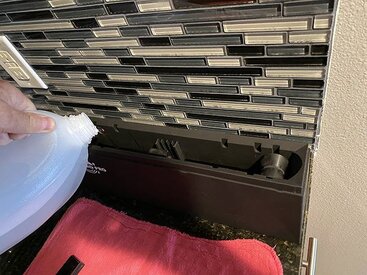

- Fill the reservoir to the fill-line with distilled water

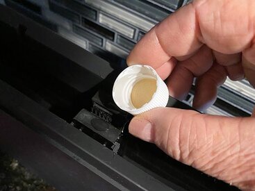

- Pour two capfuls of the supplied cleaning fluid over the installed cleaning brushes
- After waiting thirty seconds to ensure the cleaning liquid has spread evenly through the brushes you are ready to go!

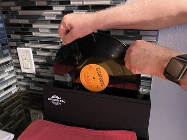

- Place the record vertically in the bath pushing it between the brushes until it is resting against the rollers on each side of the tub
- Slowly rotate the record USING BOTH HANDS three times in one direction and then rotate three times in the opposite direction
- Grasping the record on the top edge with the small micro-fiber “Handling Cloth” slowly and steadily pull the record up and out of the bath

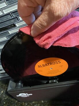

- Holding the record carefully in place wipe around the surface of the record in a circular motion with the supplied drying cloth
- Flip the record over onto another dry paper towel (or micro-fiber cloth) and repeat the drying procedure

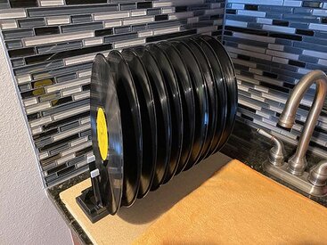

- Handling the record by the edges move to the supplied Drying Rack and allow the record to air dry for at least forty-five minutes or until completely dry
