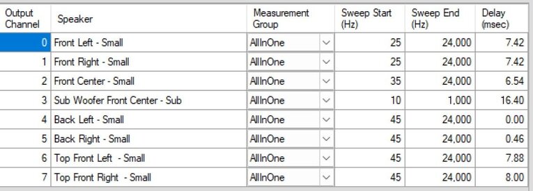

I can only tell you what I do. I measure a single point that is in line with my ears and that is equidistant from my left and right main speakers. See screenshot.
If you are measuring a multichannel system, as I did, then you point the microphone 90 degrees at the ceiling. If it is two channel only, then you point the microphone straight ahead directly between the mains (which is how you'll get an equidistant measurement reading for the left and right channels). JCR
