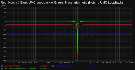

After some hour's with trial and error I finally got it right.
(Notch is dual fliege OPA1662)
This is the way I did it for the result's (see pictures for better explanation) :
1. Adjust Analysis.
2. Take measurement with notch and without notch. (-25dB - Full input on my hacked Behringer)
3. Do Trace arithmetic.
4. Measurement without notch and without cal. file
5. Measurement with notch and cal. file + manuel fundamental.
(The fundamental is measured with a good quality DMM when loaded)
I can proberly get much better result's with higher voltage from Victor's 998Hz oscillator, but I keept it around 1V,
to compare directly with full input to my Behringer without clipping.
I think I got it right this time :)
