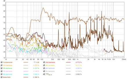

Here is my measurement file attached. It's the measurement of left speaker. SPL is around 76.5 db. Mic level is around -24dbfs in "Check Levels" window. Not clipping, there is around 5 db headroom. Is everything OK? Thank you very much for your help. With my best regards.

Looks good, about 80 dB signal to noise in the impulse response which is excellent. Looks like it was very noisy before the measurement started though, based on the captured noise floor which is shown on the Distortion graph:
