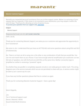

This is what Marantz had to say.

Well there you go... And kudos to Wayne... It will be interesting to hear back from you of your experience with this experiment... Have fun!!!
