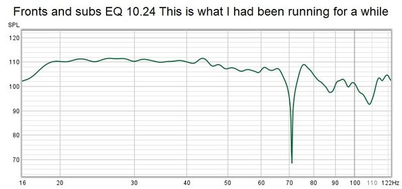

I'm hoping for some clarity on this. I've recently been questioning my sub output as I would expect it louder. I do feel movies sound decent, but when I am listening to heavy bass music, I feel it is lacking. Even looking at the subs, I don't feel like they are moving as much as I would expect. I am a lot more familiar with car audio than HT, so maybe that is it. My car was very bass heavy pushing 145db at the window. Maybe I am just deaf lol
I am running Audyssey from my Denon AVR with a miniDSP to time align and EQ my subs. I did this a while ago and haven't really messed with it since. AVR defaulted to -7 for the sub level, but I have been playing it at -3 with DEQ on.
I used REW to develop the target curve which was at 75db. I tried to build a target curve with it around 10db higher at 20hz compared to 100hz. I think the end result was closer to 6-7db higher.
I am running 2- HSU VTF 3 MK5s with both ports open EQ2. One sub is front left of the room and the other is rear right of the room. My room is fairly large and not a dedicated room. It doesn't close and the right side opens to the basement stairs, another room and the bathroom.
I did some testing tonight and attached is the graph I got. In the past I got rid of that dip around 70hz by adjusting the sub distance a few feet, but I didn't have a chance to do that before the kids got home. To me that should give me a pretty good sound. I've attached some of the other graphs, from previous testing. To me I should be getting a good sound, but again I feel it's lacking. I've also tried other sub locations like both up front and this can be the best response.
I think my next step is to re-run audyssey to get closer to a -11 trim and then bump that up to -5 to -3 and go from there. If i need to add more gain at the sub I will. Any other tips suggestions
