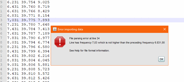

I've editied the .cal and replaced some "." with "," and bingo!

Well yes, but a file shouldn't contain a mix of decimal delimiter so that should always give an error. It will have failed initially when first encountering the 7,031 followed by 7.231, then as a fallback it tries re-parsing the file using comma as a decimal delimiter instead and when that also fails it shows the error.
Understood, this was just to force the error again. And that explaines that "6.831" is reported as "6831" on the second pass, right?
I think we can close the specific case as I didn't get any errors with correct files now.
