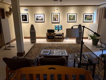

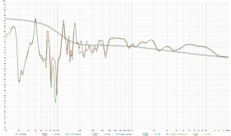

For years I've had a pair of GIK Bass Traps in the front corners of my listening room as well as a set of RoomTune panels on either side. The panels on the side were placed using a mirror. I've recently contacted GIK to discuss additional room treatment and they've suggested several additions to what I have. Before ordering anything from them I decided to measure my room with and without my current treatments. I expected to see some difference in the measurements but there doesn't seem to be much. I'm still learning REW so it's possible I've done something wrong. I have both E-Books by Keith_W as well as a number of other sources of information but I am still a newbie. Would it be possible for someone to take a look at this .mdat to see if I've made a mistake or just as likely, am misinterpreting the graphs? Thanks. (If I'm presenting this wrong in some way please let me know so I can correct it.)
