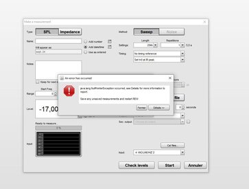

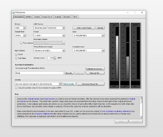

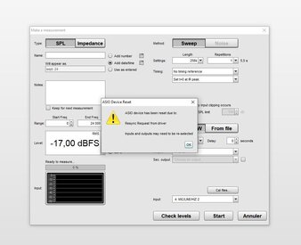

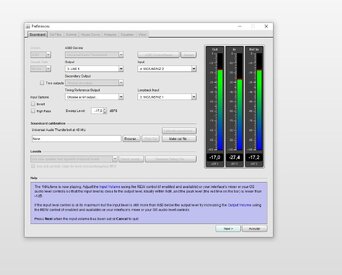

I have been trying to make REW work with my New X8P but I keep getting Java Crash Under Windows 10 ver 2004

Please attach the error report information. It may be easiest to simply zip and attach the REW log files folder, which is C:\Users\<your user name>\REW.
The error is being triggered by the resync requests from the driver, though I don't know why it should be issuing resync requests, it looked to be happy during the level check.
  • What buffer size/latency have you set for the X8P driver? Larger buffers are better for audio measurement.
  • Have you tried just making a measurement without going through the soundcard calibration? Leave the loopback in place and use the Measure button to bring up the dialog and make a measurement of the loopback.

I`m already at 1024 Buffer
I get NO sound when I try to do the measurement
I install Sonar Work Trial today to see if there something wrong with my setup but everything work perfectly the first time
Let me know if there anything else I can try
Could try setting the ASIO driver's default sample rate to 48 kHz (i.e. the same as the rate REW is using) before starting REW. Beyond that I don't know what to suggest, there isn't any information on what the driver doesn't like.
I did a measure with no Calibration and this is what I got ...
SPL scale is a bit wide :) but it looks correct. Use the "Limits" button at the top right of the graph to set the SPL at the top of the graph to 100 dB and the bottom of the graph to 40 dB.
This is what I get with the "Limits" button at 100 dB and 40 dB.
