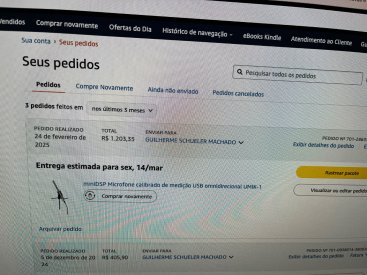

I just bought the UMIK-1
Now I just have to wait anxiously.

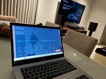

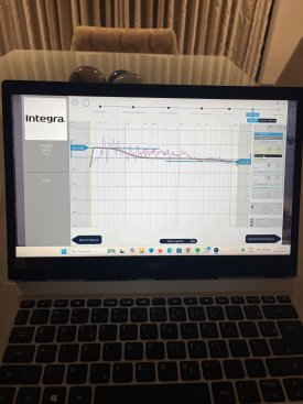

Performing new calibration on the DL.

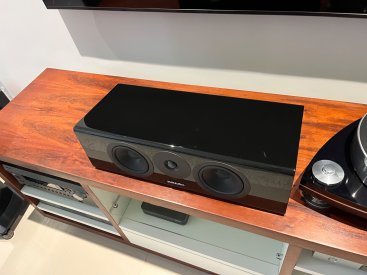

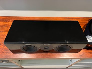

I can't understand why the DL calibration loses dynamics, body and becomes VERY low?
The AccuEq has more dynamics, body but the highs are brilliant.
Am I doing something wrong?
It's possible the levels in Dirac for each channel need adjusting prior to running. Hard to say without being there to see everything that's going on.
I did the standard calibration. I left Slot 1 as it was and increased the bass in the others.
Now all I can hope for is the UMIK1

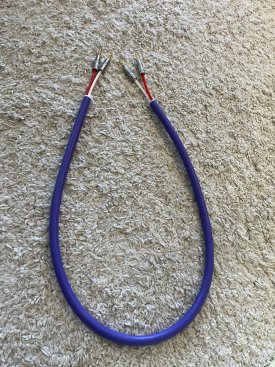

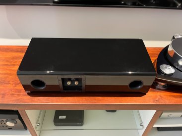

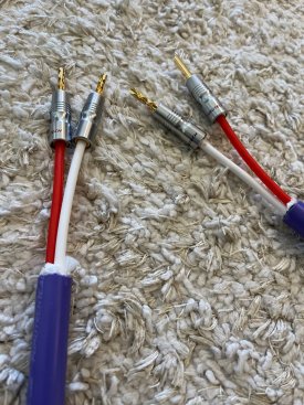

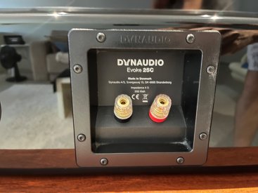

I moved the central box onto the rack and tightened the banana plugs.
Let's test it again!

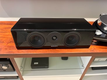

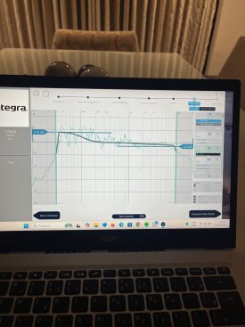

I reset the receiver and started from scratch. I performed both calibrations with the 8.4 microphone. In my environment, the AccuEq always sounds better with more dynamics, body and volume. The voices remain mellow in both calibrations. I think it will be difficult for the UMIK 1 to solve this voice situation. Unfortunately, I will give up on the DRX 8.4.
Move the speaker right up to the edge so that the sound isn't reflected.
@Guilherme66 Since you are getting the sound you like using AccuEQ, I believe the problem is not speaker placement.
I believe Dirac tries to flatten the frequency response whereas AcceEQ has limitations on how flat it make the response due to its limited Graphic EQ sliders. Essentially, if you measure your center channel, you will notice the AccuEQ has higher SPL and boost for certain frequencies where as Dirac will try to keep them flat making the sound difference. Getting another AVR say A10H and using Dirac on that AVR should technically give you the same result (or no improvements if using Dirac).
I recommend that you RIGHT CLICK on your graph and use the "Load Target Curve" as the option to load the curve that you like for greater controls. You are currently using what is called Shelve Filters with two handles to decide the slope of your curve. This is limiting your options with Dirac.
