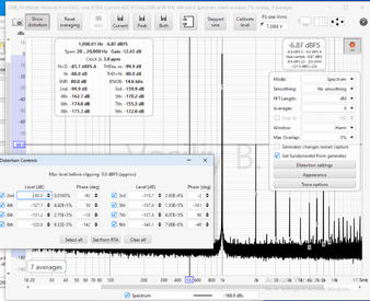

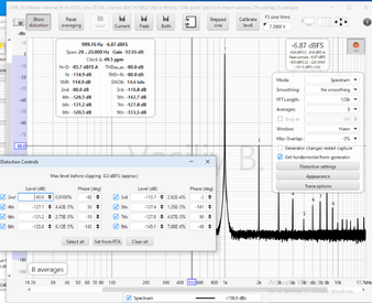

I'm getting expected results with low and medium size FFT sizes, but when i go 1-4M FFT size - THD goes wild. Check this out - i made intentional harmonic distortion at -80db using the generator and made an RTA measurement using 128k and 4M FFT. The results are drastically different. Screenshots attached. THD is different and the level of 2nd harmonic you can see on the screen is definitely not correct. Am i doing something wrong?..
REW is the latest version 5.30.9.
Uncheck "Get fundamental from generator". The slight difference in the replay and capture device clocks is enough to shift the fundamental peak into a different bin with a 4M FFT, that's why the "1" for the fundamental is not at the peak of the input. Using the generator for the fundamental frequency is fine if replay and capture are the same device, if not best to let REW work things out from what's coming in.

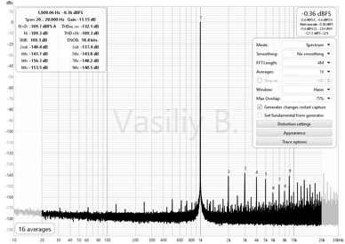

It helped. Thanks a lot.
it helped with single sine, but... :) it's always some "but..." :))

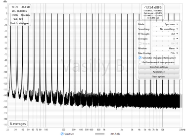

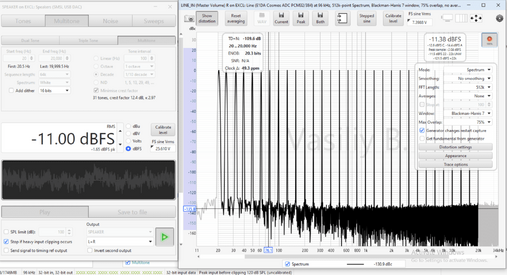

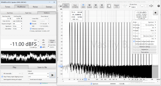

similar problem with multitone. 512k fft - no problem, 1m - it goes wild.

Maybe it's more difficult to keep track of the frequency shift and especially adjust the calculation accordingly for multitone than for a single sine. IMO these long precise measurements are better to do with synchronized generation/capture.
ok. how do i do that?
As John has already noted - using a device with common clock for playback and capture. Or using devices which can have their clocks synchronized externally. None of that is the case of your Cosmos ADC.
But maybe the clock drift tracking can be done in REW for multitone somehow too, that's a question for John.
