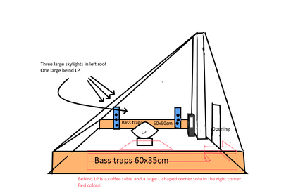

Bebbetufs
Nov 10, 2019
26
it is of course possible I'm unable to hear the differences, or that my setup is so limited that they don't manifest. And I've only compared two pairs.
Bebbetufs
Nov 10, 2019
26
To
I understand that but placement of the microphone and where you sit will effect how well DRC or any room EQ system will work and can dramatically effect the end results.
Good point. In my case the Focals were in the sweetspot when calibrated. They were also calibrated last, so my system and I was better prepared. When A/B'ing the B&Ws were on the inside of the Focals, so further away from the walls and roof. Moreover, they were not in the spot where they were measured as it was taken by the Focals. Still the two pairs sounded so similar I could not tell them apart, at least not after time spent swapping the cables and changing config in miniDSP.
My room is bad, it probably makes it hard to find out which speaker is better after calibration.

Thanks for the diagram of your room that helps a lot. Did you try changing the angle of the mic and did you use a tripod or some sort of stand? I am finding it hard to belive that two vastly different speakers sound the same and not clear.
I've not tried different mic angles, only positions. I used a mic proper boom stand. I've made many calibrations.
The speakers sound good and clear. I hear things I've never heard before. Especially the treble is vastly improved. My old B&Ws now sound as good as the much, much better Focals, which is why I'm keeping them and returning the Focals. There was no return on the investment.
The only thing I'm unable to get is the depth of the soundstage the Focals had in the custom made listening room in the shop. It was magnificent.

I saw your diagram. A picture would be better, but obviously a difficult non traditional space. The worse possible environment for a zero directivity control "audiophile" speaker.
Horns and/or other methods can be used to control upper frequencies and gradients/lines can be used to control lower frequencies. Both can greatly mitigate much of what you think are problems. Not eliminate, but rather create a polar pattern far more adapted such such an asymmetric/irregular space. You should still buy Floyd's book :)
