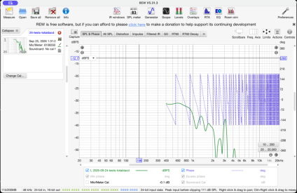

Thank you. I looked for some time but am not sure I could not find and offset in the measurement info panel. Is it the 110.9db "data offset" value?

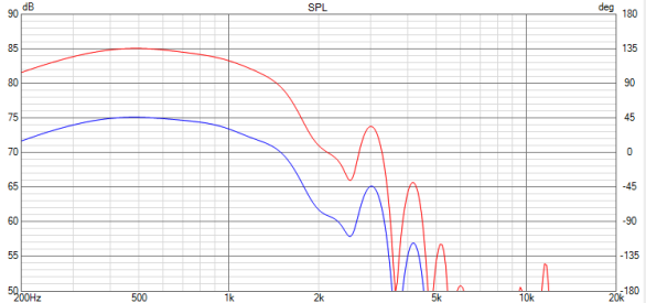

when I compare a CLIO IR export to a REW IR export (both converted to FR using the virtuixcad IR to FR tool, I am seeing a delta of around 9dB (the phase matches decently). CLIO in red, REW in blue.
Yes.
I don't know how VituixCAD decides to convert IR import levels to SPL, or how Clio scales its exports, sorry, but I would imagine it is easy to offset one or the other in VituixCAD.
Your answer helped me determine there is a scale field in vituixcad IR-FR tool which was set to a default 100dB, setting it to 110.9dB resulted in a perfect match. Thank you!
