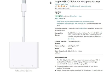

Thanks, I found my problem. My laptop only has USB-C connections; you must use a HUB for all your connections. The HUB I was using would only pass analog signals on HDMI. When I used another HUB, it came through PCM. Thanks for your help!
Sure,
The one that did not work is a very common one from Amazon that comes with many names on it. It is a " USB C Docking Station Dual Monitor 14 in 1 Triple Display USB C Hub Multiple Adapter with 2 HDMI+DP+6 USB C/A Ports+Ethernet+100W PD+Audio, USB C Dongle for Dell/HP/Lenovo ThinkPad/Surface Laptop." Mine says ZMUIPNG on it, but an Amazon Basic one also looks the same.
The one that worked is an Apple USB-C to HDMI "
Apple USB-C Digital AV Multiport Adapter"
Since I am new, it won't let me post links.
