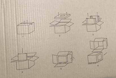

Packaging at first glance certainly appeared adequate with the box proudly displaying what was inside.
Opening the first box and folding back the flaps revealed a second equally heavy duty box. Instructions for unpacking were printed on the inside flaps of both inner and outer boxes.
Opening the second box disclosed a closed cell foam cap with the accessory boxes inserted into individual niches. Pulling the cap off revealed more closed cell foam corner and side protectors.
I then, following the instructions, removed all of the corner and side foam pieces then turning and reinserting one of the side protector/skids onto one of the two “solid” sides of the sub.
Then, turning the package over on its side and using the side protector as a sled to slide the entire subwoofer out of the package. Couldn’t have been easier!

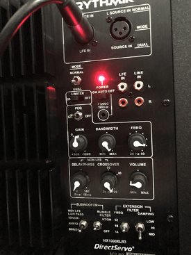

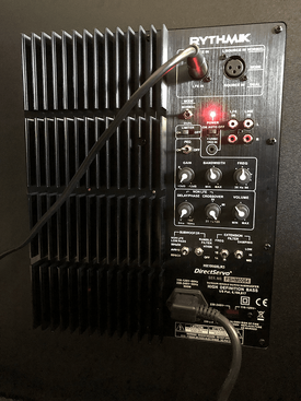

The amplifier supplied with the F18s allows for considerable fiddling. And, as I fiddled glancing over the two page instruction sheet I started the process to dial in the subs.
The 900 Watt RMS – HX1000XLR3
One thing to note is the supplied instructions may only be two pages but you should read them carefully…. Completely and carefully! There is a lot of information tucked into those two pages and you will save yourself a lot of grief, frustration and time if you read them carefully!
Did I mention read carefully? I did a very typical “guy” sort of thing and just scanned the instructions (if that). As a result I wasted a good hour, or more, in useless pursuit of a good starting point when that setup/starting point is printed clearly on the instruction sheet. I have attached them below as PDF's if you have any interest.

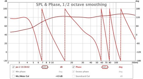

Subs Final Curve - SPL
Subs With Phase and SPL
I ran multiple iterations of the REW sub sweep test (with my main speaker amps off). I then started a movie (Edge of Tomorrow) and let it play through twice to allow for a little “Break-In” of the subwoofers. I didn’t really expect much benefit from any break-in, and I realize this was not a truly meaningful length of time, but wanted to stress the subs a bit before any critical listening.

The final resting place for the Amplifier settings were as pictured below. The only thing I experimented with, and that only with the music listening were the Damping selections changing between Medium and High.
Final Configuration of Amplifier

The Packaging
The packaged F18 weighs in at a whopping 133lbs with the subwoofer itself clocking in at 115lbs!
Setup is key with these subs and after my false start I reset and started with all amp controls/settings at Rythmik’s suggested starting point and ran another Audyssey calibration. Lo and Behold! This resulted in a much smoother curve and a much more listenable sound. I did some additional tweaking with the PEQ to iron out the smaller, but still present, dip at just above 40Hz (Room Mode). I got a curve I liked and started a Mini Break-In.Subs Final Curve - SPL
After running my little “mini break-in” I settled in for a bit of critical listening and started with movies.
