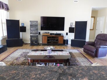

Soundlab Majestic 745's

I have a 4-way crossover that connects to the 4 power amps. I feed the signal from the audio interface to the inputs of the 4-way crossover. The midrange and tweeters are electrostats and the dynamic woofers and 24" Hartley woofer is built into the wall.
