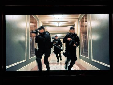

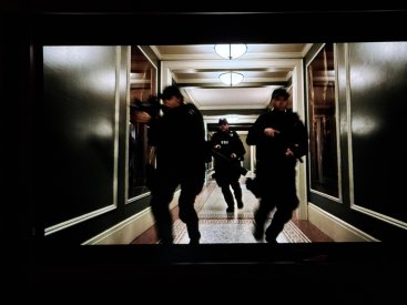

2. Following Todd's advice, I paid close attention to the TV entering HDR mode with several different HDR shows from online and disc. At initial menus, the TV seemed fine. But with certain material, it consistently changed picture either while the program was transitioning from "previously on ..." to the new episode, or during the credits for the new episode. I have pictures and will try to attach. (1st pic is correct, 2nd pic is the incorrect setting) The menu and settings in the TV did not show any change - just the picture.
