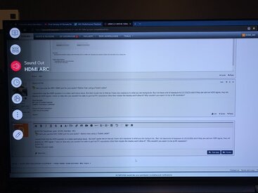

Thanks for your reply. I was asking my father this evening about my issue. He said the same thing about the ARC. So we tried that and almost got it to work. The PC is connected via hdmi cable to hdmi 1 on the tv (which is not arc). Then the tv hdmi 2 (which is ARC) is connected to the amp out (which is the only port labeled ARC). So I selected TV audio as input on the avr and selected HDMI ARC as Audio out on the tv (see image 0) and it worked for stereo at first. But Dolby atmos didn't, I had to play with the settings until it asked if I wanted to reenable something. And then Atmos worked, But I haven't found a way yet to be able to use g-sync and hdr at the same time.
