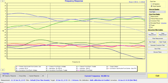

I'm new to this - but its very exciting.
I've run unto a problem where I cant zoom out the graph. This is the maximum zoom out. I'm holding left click and moving it left and up. Is there a trick?
Sorry if it's obvious!
thanks
THere is a glitch in the code that I haven't quite figured out, so sometimes the min and max values are changed when they shouldnt. You can reset it by double clicking on the chart with the right mouse button:
49436
Bottom Axis, check auto for inimum and maximum value.
And if you get a similar limitation on the left axis, you can do the same on the left.
