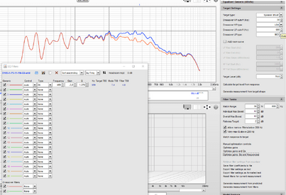

I wasn't aware of the possibilty to define my own driver target until now but defined one now. And I manually set the target level to 70 dB now. With this, REW gave me only one filter:
Seing the peak around 226 Hz this seems really odd, don't you think so?
Even when I increase the Flatness Target to 1 dB, it only generates 4 filters:
My DSP is an Omnitronic Smard-24RCA. It's a cheap one, but I already used it successfully a couple times, using (earlier versions of) REW the same way as I do now.

7,315
You aren't showing your target response and it looks like you have a house curve file loaded, which is added to the target. The differences we are getting are probably due to the effect of your house curve. What does the target look like compared to the measurement?
My target response is a plain flat line. And I'm not adding a house curve, as can be seen in this (excerpt from above) screenshot:
7,315
You are adding a house curve, that's why HOUSE is shown next to the target response value. The filename will be shown on the House curve tab of the Preferences. To see the target select the Target trace, it is not flat.
Thanks a lot, that was the piece of information I had forgotten. Now that I see it (again) I remember that I experimented with house curves long ago, but then concluded that I better target a flat response... and forgot about the house curves:gulp: Until your "reminder" I thought house curve = room curve.

With a (truely:redgrin:) flat target the EQ gives me many filters, more than my DSP accepts per (output) channel. I had to reduce the target flatness to 3dB to get the number down to 8 which I can enter into the DSP.
