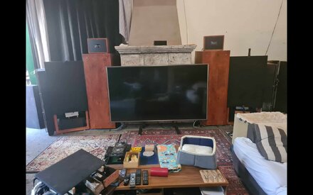

No...currently I have k402mehs horns (2 way synergy horn), and a pair of f20 sub horns. I have the setup configured as a 3 way...even though the MEHs dig down to the mid 20s. I did it this way to not push the MEH woofers ( a pair of 15" Celestion ftr woofers per k402 horn) to hard, and I currently crossover the woofers at 80hz to the f20s.
I was wondering if I ran the MEHs as a 2 way ( the normal way), and tuned both f20s as a single sub via a xlr splitter from my xilica crossover, to a amp for each f20... I would have a 2.1 setup. Does this make sense? Would tuning 2 f20s horn subs as a single sub be advantageous vs running the setup as a 3 way?
In the attached picture...you can see a 5' tall f20 horn sub partially behind the tv, and a MEH on the outside edge of each f20.
I would suggest that if your mains and your subs are all symmetrically located, as your photo seems to show and if your are driving them in the sub 80Hz range you may run them as you are thinking as 2.1 system... Otherwise, why not run them as stereo subs as in 2.2 system... Or if not symmetrical, then one might need to time aline them... Just a little food for thought...

They are symetrical (around the fireplace), BUT the left channelis about 5' from the wall and the right channel is 20' from the wall
Once again, this is the point where only by trial and measure and what your own ears reveal about which method gets you to your audio nirvana... It is also possible that you may create more problems with room modes... I don't remember if you have your room squared away with treatments...
"BUT the left channelis about 5' from the wall and the right channel is 20' from the wall" is the part I would wonder about...

They are about 6' apart from each other and equally 12' to the mlp 12' away.
Well, if you have them spaced like that, treating them like one is much less problematic!
