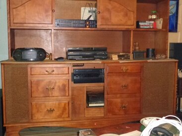

DSC00251.JPG Also along those lines above, I never coil my cables. Any of them. If there is enough length, figure eight them. But not smaller than 6-10 times the cable diameter. Every little bit can help. And don't be afraid to use the B speakers.....
