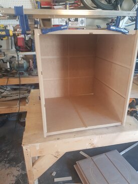

Got one box done late this afternoon in about an hour...
Looks good. Did you use screws and glue or finishing nails and glue? Also if you don't mind me asking, what was the total cost?
The kit cost $400 direct from PE... or $800 for the pair. Then there is the polyfil (about $22 at Walmart for 10lbs)... glue, terminals, gasket and Duratex finish... figure on another 50-60 bucks.
I used glue with clamps until I was able to staple it. I used the 1/4" crown x 1-1/2" staples in my air stapler. I will sand and fill the staple holes then finish it.

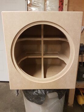

Both boxes are together and sanded.
Very nice. I'm convinced unless you need a customized shape/size, there's no better way to build a DIY sub than starting with one of these. Building the 12" and seeing your 18"s go together so nicely has me thinking I might should get 2 or 4... or 8 of them for my HT eventually too.

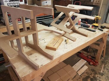

Thanks! Yeah... really easy to put together. It would have taken me quite some time to cut these out like he did... definitely need a DNC machine for this type of cutting.
Nah... Just a chisel,chainsaw and some woodfiller. Not so bad haha
