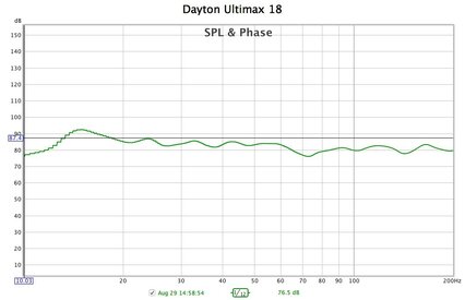

I built mine from a kit, which included their SPA1200DSP plate amp in a bundle. The first amp failed within 2 months, so I exchanged it for a brand new one. That also failed within a few weeks, and I was told that they are redesigning it and would contact me when another one was available. That's been a year. It's also worth noting that their DSP control software is horrible to use and also doesn't work properly. I was unsure of it originally, so instead of building it into the cabinet I put it in an external ventilated enclosure, which meant I could replace it without leaving a gaping hole. Frankly I'd avoid the amp and just build the sub, in case you were thinking about it.
That said, the sub itself in their default sealed box has been excellent. It's now powered by a bridged Crown XLS1500 and never fails to please. I only listen to music through mine (no AV, no LFE) but it does a fantastic job of producing 14 Hz organ pedal. The attached graph was achieved by actually reducing a few room mode peaks; there's no boost applied below the crossover frequency (63 Hz).
