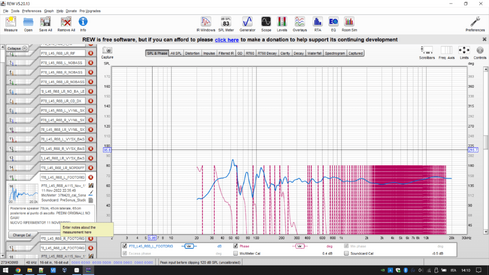

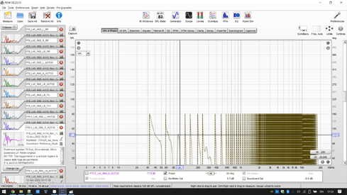

Hello,
Maybe this is a noob question, but I'm new of REW :greengrin:
I'm trying to generate some EQ filters for my mesurements. In general, I'm able to generate a good EQ but there are some "holes" in the bass range that seem to be "ignored" by REW during the "Match Response To Target" process.
Please, look at attached picture. There is some way to "fix" che frequencies "in the pit" around 65Hz, 95Hz and 140Hz?
Many thanks in advance!
Bye

Generally speaking those are nulls... A common thing in "small rooms"... You won't want to boost those... Without a little more information about your room or system and what your use case is (Stereo, HT, etc) there are a few things you can try... Move your sub(s) if you have some... Move your main listening position... Add bass absorbers and if you only have one sub, you could add another...
In REW you can use the Room Simulation to see what may be going on in your room with your speakers...

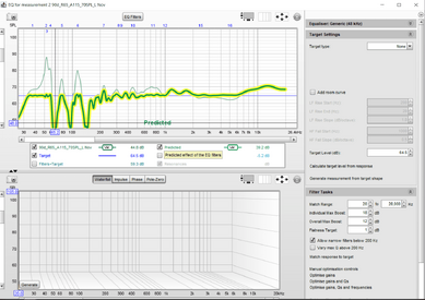

eh, the main problem is the room dimension: 10.5 feet x 10.8 feet x 9.51 feet (9.51 is the ceiling and this one isn't treated).
I've tried to boost the nulls and the problem seems to disappear but I exaggerated and in some cases the left speaker goes into overdrive. I can work on it but if this isn't the right methodology is better to avoid it...
Is it your floor or ceiling??? A coffee table??? It does seem those speakers are down firing for bass... Hard to predict what is really going on in the room...
I believe boosting nulls just magnify the issue of nulls... 15db is a lot to boost... You might try moving the mic around the room and see if you can find the issue... 100Hz is about 9.8 feet...

Ah, the dreaded square room... Lol... Almost a cube... Try and visualize what is going on with https://amcoustics.com/tools/amroc... The thing with boosting is how many watts does it take to boost by 1db... Now think of what it takes for 15db... The other thing is if there is pre-ringing and if it is audible... To be clear... Boosting nulls isn't the right methodology...
And this may be a fun read for you... https://www.audiosciencereview.com/forum/index.php?threads/solving-bass-nulls-with-dsp-or-not.35473/ Especially post #5...

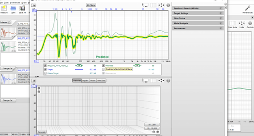

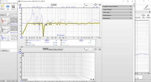

And now:
1.
I advanced the listening position of 10cm.
2.
I moved (again) the traps in the back not at 45° in the corner but more towards the center of the room (a little, the corner is ever covered).
3.
I moved the first reflection panels more close to the speakers.
The situation has changed! I think in a better direction! Basically the nulls are decreased and, magically, there isn't the 100Hz nulls in both speakers, but now the left one has the major nulls at 65Hz and the right one has the major nulls at 135Hz. Because one speaker balance the other one, now the situation is audibly better listening to the most critical tunes.

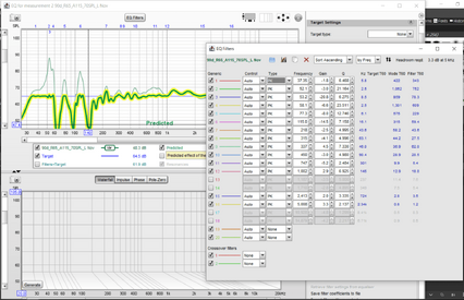

After a lot of mesurements and movement of acoustic/not-acoustic elements in the room, I totally recovered the "hole" in the 130-150Hz!
Apart the "boom" in the bass range 40-60Hz (I'm planning to add some additional traps for that in the ceiling), the main "holes" are in the ranges 60-75Hz and 80-100Hz (the bad one).
The REW Room Sim shows a problem in the room in those ranges and maybe the current acoustic treatment isn't able to recover the situation and I need to add some specific traps.
But...looking at the phase graph there is something "weird" in the left channel (the one most affected by the "holes" problem). Can you confirm there is a problem here or I'm misinterpreting the graph?
