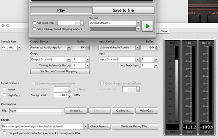

You can select a secondary output on the generator if using ASIO drivers (image below) or use L+R as the output channels if using Java drivers. If that doesn't work let me know and I can restore the previous behaviour.
Hmm.. no difference.
If I change the generator output routing in the lower dropdown it changes the output in the first output stream menu in the preference pane. I'm not quite sure what "output stream" means, but I assume it' sthe assigned hardware interface driver?
"output stream" and "input stream" are device names assigned by the device driver or the OS, REW doesn't control those. As you are on macOS you are using Java drivers, the dual output pairing provided for Java drivers is channels 1+2. You should be able to use the output channel mapping control to assign your physical measurement and loopback channels (7 and 8) to logical channels 1 and 2 and then use 1+2 as the output channel selection.
Ah yes, that was it entirely..! Thank you so much for your patient guidance. After calculating all the driver's channel number offsets (for example the UA Apollo uses 1 & 2 as the monitor outputs, so the 8 patchable I/O are numbered 1-8 on the inputs and 3-10 for the outputs) I was able to map the channels .
That's good. I will restore the previous behaviour in any case, shouldn't cause issues as it is only when using loopback..
