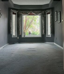

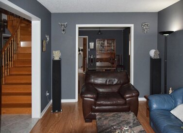

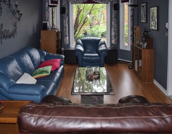

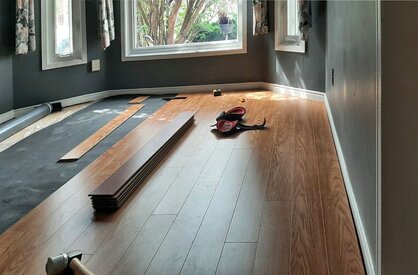

With reference to DanDan's response, most intriguing - opened my eyes to technical aspects of sound absorption. I found a good introductory article on this, check it here "Sound Absorption - an overview | ScienceDirect Topics" (I cannot post links yet, sorry) Thanks DanDan, more food for thought. (I assume you meant - "There are Acoustically Absorbent plasterboards and plasters.")
By my estimation, I have gone from an αw of about .65 with carpet and under pad to αw of possibly less than 0.1 with laminate, at least at upper frequencies. No surprise then for echoes/reverberation...
I have attached before and after pictures of my listening room (living room) flooring for clarity.
As I said, more food for thought. We will see...

The boards are absorbent but quite thin. So the heavy lifting can be done by creating a void behind/above and filling with light fibre.

Thanks for the photos. You'd have to convince your better half, but it should be possible to fairly unobtrusively treat a significant portion of the ceiling. The folks over at RealTraps have a flush-mount kit for RFZ panels, and they may be able to match the color of your ceiling close enough that they would blend well.
You could also pick up a couple of stand-mounted RFZ panels that you can drag out of a closet and place on the sides for serious listening and then put away when your wife returns. :)
