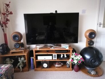

As you can see from the attached photograph I have in my system five separate drivers with each with their own amplifier.
I can't find any information using r e w to set up an equalise such a system.
I remember when I first set up my system a few years ago I equalised each separate driver by itself but I don't have that information now and perhaps it's wrong today anyway.
I will be most grateful if you can give me some advice of how to set up my system properly. thank you very much for all your help. IMG_20201008_083351.jpg
I will be most grateful if you can give me some advice of how to set up my system properly. thank you very much for all your help. View attachment 35841
7,296
EQ is mainly relevant for the region below a few hundred Hz. Assuming your 5th driver is effectively a subwoofer that can be treated as a sub and measured on its own, for left and right you would then only be equalising one driver on each. Again, you can just measure left and right speakers independently.
