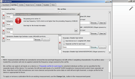

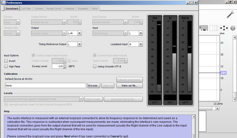

My REW stopped accepting old calibration files, and I can’t make new ones - the screen is small. Can I make hot keys for controlling YES / NO (Enter / ESC), or transfer existing ones to the working field of the screen?

Please attach the cal files which are not loading.
The minimum screen resolution for REW is 1024 x 768. Designing all the dialogs to work on a screen of 1024 x 600 is very limiting, but I'll see if there is something I can do with the generator.

Or maybe there are hot keys somewhere to complete the calibration (I just don’t know)) otherwise I can’t leave the procedure?
Attached file renamed to txt
The file will be OK in the next build. You can press the space bar to step through the calibration process, or Tab then the space bar to cancel it.

Happened. albeit hard ... why did the compensation work smoother earlier ??
