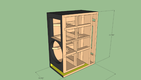

Just a quick teaser for an upcoming project (Next 2 - 3 weeks).
Drive units will be Acoustic Elegance TD10-m and Beyma TPL-200/h. Similar to a Vapor Arcus in driver compliment, with the 200/h instead of the 150/h, and active with MiniDSP PWR-ICE250, no "ambiance" HF unit, and a simpler construction that might lend itself to being copied, should anyone decide they want a pair.
Drawing will be updated with the final, this one is just a general idea.
I will edit / add to this as the rest of the parts arrive and dust making commences.
:D
Very interesting. What is the section on the back for?
Any idea what these might run cost wise?
Funny I was just reading about your ideas on another thread. happy to see a thread here now. Also will be nice to see results from your build to compare to. I have a build that will start shortly using the 150's and PHL mid in a 3way.
Sonnie: The section on the back is to house the plate amp, I'm putting minidsp pwr-ice250s in there. :) I may even add a small fan, the icepower modules get right hot if you keep your foot on the gas for a while. As far as cost, it's a fairly pricey speaker for diy, although I got a pretty outstanding deal on the HF units from a beyma dealer, each one is hovering around 1400 + wood. It's definitely going to be my reference speaker for many, many years if it turns out right.

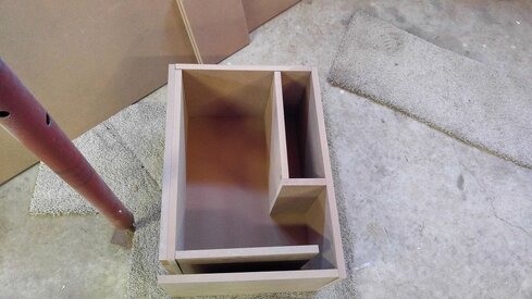

Made a little dust today, got all the major exterior panels cut.
Side note: Track saws rule, I'm so so sad that I waited so long to finally get one.

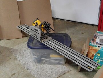

Got a pic of the track saw?
Yes, where are those pictures of this track saw you speak of. :greengrin:
Sure thing, I got the Dewalt one. I almost got the Festool one, but a couple of reviews I read comparing them said they performed similarly, so I went with the less expensive option. Got the package that comes with 59" track and 102" track, so it'll go across 4x8 sheets.
It's nicer to work with for speakers than the table saw, at least so far.
I just flop the sheet of wood up on an old workbench that's about 4x8..drug it outside to use as a cutting surface from now on. I put a piece of cardboard down over the top (had some conveniently sized cardboard spacers from my wood delivery) and adjusted the plunge so it cuts the wood and just barely nicks the cardboard, so now I've got a workbench topper that looks like someone failed at a giant game of tetris on it :P

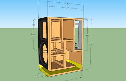

I know subs will be present and accounted for, but do you have a projected F3 and/or F10?
Lol, that is a pretty good name, considering.
Vent tuning is about 37hz right now, but I'm considering a vent plug, so I can try them sealed with some midbass modules.
