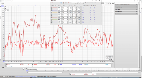

Even with "Drop filters if gain is small" on I'm getting 0 gain filters
dima1stg
Dec 3, 2019
65
Build is 5.20.13. Please see attached.
