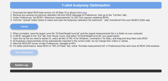

No, this is used in conjunction with the Audyssey MultiEQ editor app found in the appropriate app store for the phone you use. Its a 20 dollar app.
Download the link in the description of the video and follow the instructions.
It will look like this
The other downloadable file are demos

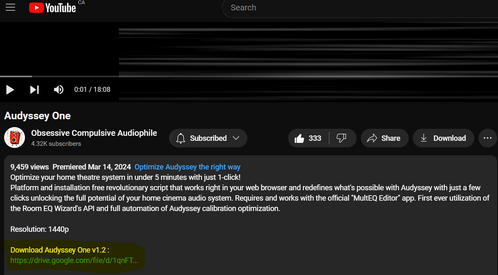

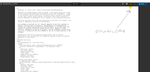

Do you have to download an App? I'm still confused if this Audissey One is something that you have to download
Youtube screenshot, Click on highlighted link and it will open a page full of text that looks like the second screenshot
The second screenshot, hit the download button and that it will save a Html page that will open the Audyssey One page that I screen shotted earlier in this thread
There is no stand alone "App" per say just a web page that runs in conjunction with Rew after following the prompts from Audyssey One
You have to download a script that he provides in the video description. The script runs on any web browser, chrome, Firefox. opera. But you do need to have the Audyssey phone app which is $20 dollars from the apple store or the google play store. everything is very easy to do.
