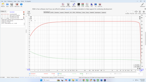

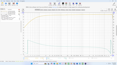

I have been having some high frequency measurement issues (excessive rolloff). I have been using a Motu 2 for audio interface. I have attached a couple off screenshots. Screenshot 71 is my old mobile Pre audio card. The phase is linear to nearly 22KHz. Screenshot 69 is my Motu 2. The phase goes craxy after 10KHz. Is this normal? The frequency response is fairly flat +0.2dB, -1.6dB. What would be expected values for phase and frequency response?

I don't think it would be an issue, as it's not uncommon to see phase shifts with different filter designs in that last octave from 10kHz to 20kHz. It could be a more aggressive anti-aliasing filter in the Motu 2. Again, with the response looking good, I probably wouldn't be too concerned about it.

That is rather odd since the loopback response is smooth out to 22kHz.

I agree about the loopback response being flat. Motu specs it as +0dB, -.01dB 20Hz to 20KHz. The phase response is what is causing the high frequency rolloff in my speaker measurements. FWIW I tested everything including multiple computers, Motu's, cables, ASIO vrs Java, - you name it and I tested it. Right now my objective is to get an audio interface card I can rely on for accurate measurements. i then plan to ask Motu what is the reason for the terrible phase response. I can onlu guess it is to minimize recording noise.
