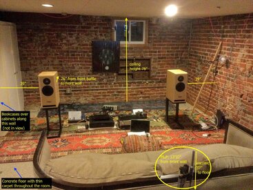

I'll answer a couple questions you asked with an attached photo. Basically, a concrete floor with thin carpet. Ceiling is drywall.
I don't see anything wrong with your measurements at all. It would have been nice if they extended a bit higher than 340hz. However, if 82db +/- average between 240-360hz is your average sound level, then essentially, you have predictable (and innocuous) monopole box stand speaker dip in the expected 210hz range, a bit of front wall cancellation at 140hz and a small, 3db ish peak at 80hz.
By far, your best money spent would be to buy/read Floyd Tooles book about how what you have measured there, despite looking scary to a single pressure mic/your eyes, is perceived quite differently by 2 ears and a brain...aka, a living binaural hearing system. I don't see anything there that can't be "fixed" by a couple subwoofers, namely the issue of the bass falling off below 80hz. The peak at 25hz could be noise, possibly HVAC.
How does it sound? That is the only thing that should really matter.
cheers

OK the clipping is an issue, waveform very distorted. Please make mains to front wall 72", repeat L plus sub@65Hz crossover mic at MLP ( the mic for now should be at your ear level center of head.) Increase the gain on the sub 3dB if you can. (later we will make multi mic or moving mic measurements. Toe in speaker so left axis points at last ear, right at right ear.
Do 2 sweeps 0 degrees phase then 180. Make sure there is no clipping anytime during the sweep. Are you using a UMIK1?
BTW this looks like ballpark settings if the sweep is not totally clipped. 0 degree phase is better. Give it a listen sub on sub off and comment.
Later if you can find the time:
1. Move the equipment between the speakers to the front wall.
2. Move the computer behind the MLP,, close the screen when not listening.
This will make a subtle audible change but will improve our measurements a lot. Right now there are enough reflections that it is hard to see the forrest for the trees.
3. Right now the biggest impediment to clarity is the huge reflection at about 1.8mS. If we can get this down in level it would be good. I think it is a ceiling bounce.
If you want to go for it we need to positively Identify the offending surface. You can build a little tool that I use every day. I build them and give to audio friends but am out at the moment. Goggle Calibrated acoustic string and print out the instructions. This is just a way to build a device that measures in time. It is calibrated in mS (.001S) rather than feet. Very useful when you are looking for a bounce or reflection that delays the sound by 1.8mS. The instructions explain how to use it. In a pinch a piece of string and some tape is all you need.

Yes, although many people like to place their audio gear between the speakers it is actually the worst place to put it acoustically. In that regard the best place is out of the room or at least on one sidewalk behind the first reflection point.
Tube gear has very high input impedance typically which makes it susceptible to response changes and noise pickup with long. Input leads. You are probably better off using longer speaker cables of suitably large guage.

First this is now good response, congratulations! To get it much better will require EQ and some judicious room treatment.
It appears there may still be some issues with the measurements. Measurements labelled the same are significantly different. Do you have any noise in your room?
I hate to be such pain but can you run once more with just 2 curves?
1. Sub with left at MLP, cross@65, gain 9PM, phase 0 then 180. Make sure the mic tip is right where the center of your head would be. I would point the mic at the speaker being measured, I know many say it doesn't mater by it does make slight differences at high frequencies. Make sure you use the 0 degree mic cal file.
No need to run the 1" curve anymore.
Then listen a bit at the 180 degree position. Tweak the sub level up and down from there and make a note or mark at the level you prefer. Then just listen for a while. It should sound pretty good if these curves are representative. Let us know what you hear, good or bad.
