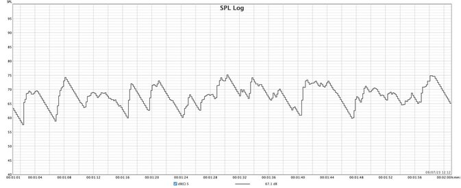

Yep, can be hard to get a “read” on dialog levels if they jump about a lot. Judas ATBM was very much like this too. That’s why I’m measuring with SPL logging in REW. Having that graph makes it easier find both the loudest and the quietest bits of dialog in a speaking scene (ignoring any deliberate whispers or shouts) then take the average of them.
Obvs I try not to measure any dialog scenes with background noise - either the background will push the SPL up itself, or the characters can be speaking louder or be mixed louder, to get over the background. (Except in Nolan movies ;-)
It’s def not an exact science tho, for sure. Sometimes it’s just a best guess, and then I see how it goes. This method seems to get me close tho, and I prefer it to just starting at (new) reference level, and then finding it takes half the movie to establish where to leave the volume control.
To demonstrate your point, here are some examples from Interstellar. For these measurements the volume was set to 72dB with -20dB pink noise on the center channel. A bit lower than what I've found is right for a typical film for my system in a ~1450 cubic foot room. As you will see, it varies quite a bit.
In this one you can see the change in dialog level between the front porch scene and the ball game scene at 1:25 into the log.
Here you can see the dialog change between the conference room scene and the tour that follows. That's like a 6dB change which perceptually pretty big.
This is Romilly explaining the wormhole to coop. Down about 5dB from the school conference scene (1st chart).
And just for fun, this starts at entering the wormhole. This was recorded -20dB from all the previous charts in this post. Hey, it was 7am here! This would have been 102dB at my setting and makes me question whether the absolute decibel values can are correct.
The LCeq 1 minute average appears a good way to judge volume level of a scene vs. eyeballing the logged C weighted slow SPL. What do you think?
I'm using REW V5.20.14
I'm on board with your methodology. While it can't be perfect due to variability of dialog within a mix it's better than setting to a (somewhat) arbitrary value.
It would definitely be easier to use the BEQ gain adjustment recommendations. Going forward, I'll continue to compare that vs settings based on dialog levels to see if there's a consistent correlation.
Be nice if there was software to do this! Dolby LM100 is available for short money.
Also, I've read that dialnorm values are "typically" -27dB from fullscale. That would equate to 78dB. In my room I've found -9dB or -10dB from reference is where I land after setting based on a dialog volume. It's interesting that this correlates to:
1) 75/76dB for reference (with -20dB pink noise) which is is the number in the chart in post 28 from @VJM
2) The "typical" dialnorm value.
So if one had the actual dialnorm value used in conjunction with the recommended reference SPL in post 28, would one presumably have the volume correctly for each individual film?

Yes, interesting. Think we’re all converging on similar conclusions.
Reading those graphs is challenging because obviously you need to indentify what’s dialog and what’s silence. Generally the peaks are Dialog, the valleys are gaps between lines/words.. so I’m taking the value of the highest peak and the lowest peak as the high and low Dialog values.
The release time of slow response is SO slow that the valleys are more a measure of how long a silence is between lines of speech! The longer No-one speaks, the lower the trough goes.
I’m aiming to grab no more than a minute of dialog for consistency. Too much and it’s too hard to read.
Its funny tho, because you beat me to the punch there - I was also wondering if it might be possible to measure an entire chunk of a dialog scene as Leq, to directly get a value for average Dialog level.
I need to figure out exactly how Leq works.
Does it equate that to what we’re doing? Maybe it’s easy to translate to our numbers.
Re dislnorm, it relates to the level the dialog is mixed at on the meters, rsther than the SPL in the room, so it’s a bit impossible to know if dialNorm has been set accurately by measuring SPL.
One of the things that *might* explain why blurays always seem a bit loud is that the encoder usually has dialNorm set to -27 as default, but the recommended target dialog level for broadcast is often quoted as -24LKFS. So it’s possible people are mixing Dialog louder than the dialNorm is set to, which would cause levels overall to be 3dB too high,
Could be wrong tho!
Fun.
Still lots to investigate for me, not enough time right now.

So, just to relate what I’m saying about guessing an average Dialog level, the min dialog SPL in that Judas ATBM chart is 68dBC, and the max is 74 or 75dBC. Average of those is 71dBC, which is what I’ve settled on as a good target dialog level in my room.
(That’s because that graph was measured AFTER I’d established my preferred listening level for the film… which was +2dB above new 79dBC reference)
