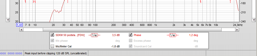

It seems if a frequency-dependent window is used or a time offset is applied, there some smoothing is forced (it appears to be 1/48) that cannot be removed. The storage of the measurement is also affected by it, as a result of which the frequency response of the pulse is then returned only as smoothed, not original, even if the pulse appears to be intact - probably the smoothing has been somehow included in the data file. This represent a certain unnecessary loss of information about the details in the frequency domain, which, if using the time shift or adaptive windowing, cannot be avoided.

A frequency-dependent window has an inherent smoothing effect, as frequency increases the window gets narrower and so frequency resolution is reduced correspondingly.
Time offsets do not themselves cause any smoothing, though the preview that is shown is a 96 PPO log-spaced trace. There is an option in the Analysis Preferences, Frequency Response section called "Allow 96 PPO log spacing" which has an effect, however. From the help:
The Allow 96 PPO log spacing selection controls whether REW is permitted to convert frequency responses from linearly spaced data to logarithmically spaced data at 96 points per octave. The FFT that calculates the frequency responses produces data that is linearly spaced in frequency, i.e. there is a constant frequency step from each value to the next. For the high frequency parts of responses this means there are a very large number of points, using a lot of memory but not contributing anything useful to the displayed data. When this option is selected (it is on by default) REW will automatically convert frequency responses to more efficient logarithmic spacing with 96 data points in each octave of the response if this will reduce memory usage (which is usually the case for sweeps that end above 300 Hz or so). As part of the conversion process REW first applies a 1/48th octave smoothing filter to the data to remove any high frequency combing from the response. The conversion takes place on any new measurement or when an IR Window is applied. Whether a measurement is log spaced or linearly spaced can be seen by bringing up the measurement info window by clicking the info button in the toolbar.
Note that conversion to 96 PPO is inhibited if the impulse peak is far from the impulse zero time, where "far" means the peak is offset from zero by a time that corresponds to more than 90 degrees of phase shift between samples at the measurement end frequency. This is to prevent aliased phase data at high frequencies which would lead to incorrect group delay figures.
If you turn that option off then reapplying the IR window will change the response back to linear spacing and smoothing can be removed.

A frequency-dependent window has an inherent smoothing effect, of course, but if the frequency dependence of the window is removed (the box unchecked and window applied again), the smoothing 1/48 remains and must be removed manually in the Graph menu. So in fact it seems it is impossible to create the frequency response only with the inherent smoothing by the frequency dependence of the window, as the additional 1/48 smoothing is present still if the frequency dependent windowing is enabled (and applied).
Concerning the smoothing at the time offset applying, my approach is as follows:
1. I create the frequency response, i.e. magnitude and phase, of the native impulse response of some loudspeaker driver, where the initial time is some miliseconds e.g.
2. I set the time offset manually so that the phase response correspond with the presumed phase response, so far is all O.K.
3. I apply the time offset set by appropriate clicking. And, what a miracle, the response curves turn to the smoothed appearance, again as 1/48.
4. I save the result in a separate file.
5. I recall the measurement from this file and the responses are smoothed still, although no smoothing was applied explicitly, though, the impulse response is the same as the original, except of the time delay correction, of course.
The examples of the measurement both as original and with the time offset (1.465 ms) applied are above (note the file containing the offsetted measurement is a little bit smaller than the one containing the raw original, although the impulse responses are the same).
I note the "smoothing" appears if the time offset is long sufficiently only; the minimum value for the example as above is a little bit more than 0.18 ms without any transition or warning (at exactly 0.18 ms no smoothing appears). I simply don't understand this behavior of the REW.
Soo ... so that is by my eyes :rubeyes::olddude:. Am I out of bowl totally ?:banana::dizzy::eek:

The answer is already posted above, but I will rephrase it.
REW has an option in the Analysis Preferences, Frequency Response section called "Allow 96 PPO log spacing". It is on by default. When that option is selected REW will, if possible, convert the results of windowing the IR (which can happen for many reasons) to a 96 PPO log spaced format. If a measurement is being converted to 96 PPO it must first be smoothed to 48 PPO, otherwise the conversion would cause aliasing. Measurements that are in 96 PPO log spaced format must always have at least 48 PPO smoothing.
You can see if a measurement is log spaced or linear spaced by looking at the measurement info Freq spacing value, here is an example of a log spaced measurement:

Even if the Allow 96 PPO log spacing option is selected a measurement will not always be converted to log spacing. Conversion to 96 PPO is inhibited if the impulse peak is far from the impulse zero time, where "far" means the peak is offset from zero by a time that corresponds to more than 90 degrees of phase shift between samples at the measurement end frequency. This is to prevent aliased phase data at high frequencies which would lead to incorrect group delay figures.
  1. If you do not want log spacing to be allowed, deselect the Allow 96 PPO log spacing option.
  2. If you have measurements that are log spaced and you want them not to be, make sure the Allow 96 PPO log spacing option is not selected and re-apply the IR window.

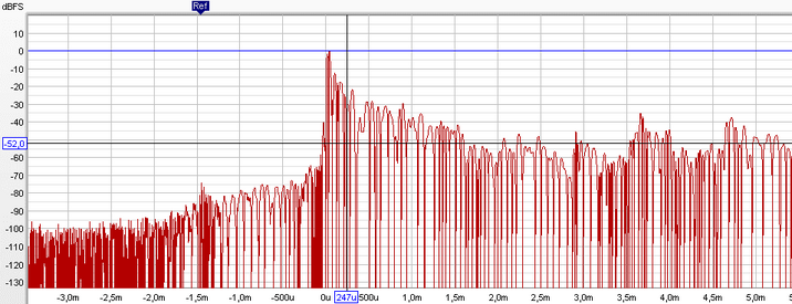

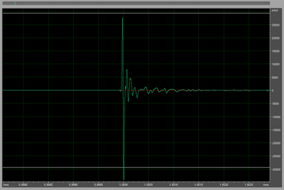

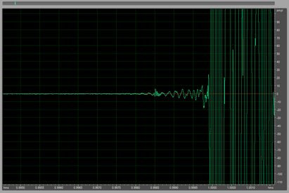

.I understand, really. However, what I don't understand is how and why the decision between "smooth or not-smooth" depends on whether or not time offset is used. By the way, the time difference between zero and the peak of the pulse certainly does not depend on the time offset, but the presence of smoothing does. And something else - which is actually or how the pulse zero is defined - see the attached pictures.

It seems I don't understand what is the peak and zero. The shape of the pulse can not change depending on the use of any time offset applied, after all. And, if the position of the zero and peak is derived from the shape, i.e. from the time run of the impulse, how the difference between them can depend on the time offset applied ?
I evaluate usually the measurements of multiway speakers. If I want obtain correctly time-aligned results, then I must set the time offset so that the phase response of the driver being minimally delayed by distance of microphone were near as possible to the minimum phase response of the driver. The other drivers measurements is then set to the same time offset. And, as I use the time dependent window, I must set the window reference time to the impulse beginning, i.e. to its threshold. The position of the peak is interesting, of course, but not important in fact. What bothers me a little is the 1/48 smoothing introduced if the time dependent window us used, which cannot be removed. This does not depend on the 96 PPO checking or unchecking, btw.
The response lies along a time axis. The time corresponding to t=0 on that axis may lie anywhere, it is not a property of the response plotted along it. The start of the response (in the sense of its causal nature) may be at t=0 or it may not, if it were always at t=0 you wouldn't ever have to do any time alignment. Time delays in the response (or delays relative to some other response chosen as a reference to define t=0) mean the start of the response is not at t=0. The position of the response peak relative to the t=0 point on the axis is a proxy for time delay, if the time delay is not sufficiently small the rate of change of phase at the end of the response would be too large to be represented using 96 PPO without aliasing.
A frequency dependent window may alternatively be described as a window whose width is a constant octave fraction. It is meaningless to refer to an "unsmoothed" response if the response has been obtained from a frequency-dependent window. It makes no more sense than asking to see a windowed response without the windowing.

There is no additional smoothing. The result of the FDW has no content beyond 48 PPO so it is simply sampled at 96 PPO. REW will show 1/48 smoothing (i.e. 48 PPO) for 96 PPO log spaced data since it would violate sampling theory for there to be any content above 48 PPO. If it helps, read the 1/48 smoothing indication as "This data is log spaced at 96 PPO".
