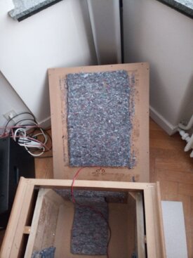

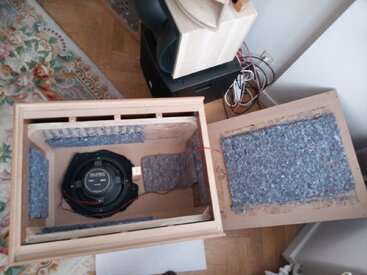

gregory
Jul 19, 2017
Belgium
Onken altec 414
