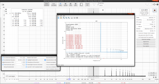

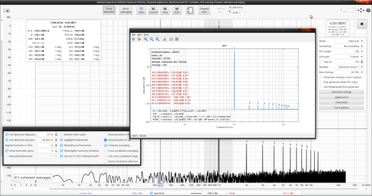

Example ::
Generated theoretical reference signal:
From -150dB THD to -160dB in 1dB steps.
Noise level in the FFT = -165dB at 32K samples
48KHz sampling rate.
1st REW measurement in "coherent averaging"
2nd REW measurement in "simple averaging"
To avoid the impact of noise variance, a large number
of averages was chosen.
(Of course, I did hundreds of theoretical examples and direct
measurements before deciding to write this)
In the first case, the THDs align at worst to 0.3dB
In the second case, the THDs align at worst to 1.9dB.

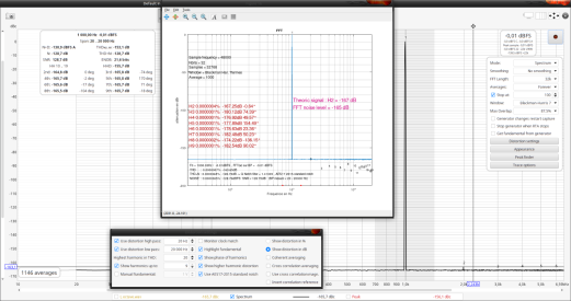

Attached is an extreme measurement:
Unaligned frequency = 1000 Hz
H2 = -167 dB
Noise in the FFT = -165 dB
REW Measurement deviation from 167 -> 2.2 dB
DIY Measurement deviation from 167 -> 0.25 dB
A run through "coherent averaging" will show you -167 dB for H2.

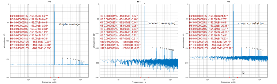

Je donne ensuite une comparaison entre toutes les méthodes

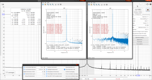

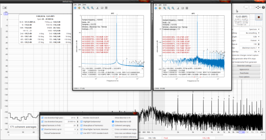

I'll give you one last example: a measurement on a D10S topping.
