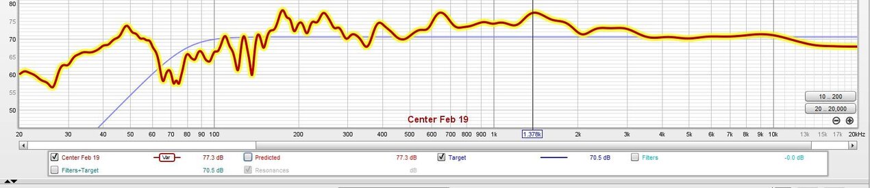

  1. I have taken my first measurements from the speakers. On REW I'm using the asio4all output to isolate each speaker channel individually. The AV Processor is supposed to have a 24db high pass filter at 80 Hz for these speakers. When running the measurement I used the range 20-20K Hz which based on REW's manual says it sweeps from 10 to 40K I believe. Anyhow, The resulting measurement for all the speakers has a large SPL peak at 50 Hz (see attached screenshot). This is unexpected to me as to my understanding the digital high pass filter (i.e., crossover) in the AV Processor should stop signals from coming through at that low a frequency (or at least heavily attenuate them). When a use REW to generate EQ filters I plan to program back into the AV Processor (has built in 11 band PEQ for each channel) most of the filters are used to decrease this large 50 Hz SPL peak leaving less for correcting signal within the frequency range the speaker is actually supposed to carry (80 Hz +). Questions:
    1. Why are my speakers producing a large SPL at 50 Hz even though they supposed to be high pass filtered at 80 Hz, is this some room/speaker resonance that's amplyifying what should be an attenuated output at that frequency?
    2. I wouldn't think the speaker could even do that low a frequency (only 6 inch woofer) so is there any chance some of the signal in the test is leaking into the subwoofer?
The attenuating is for the main channel speakers. The attenuated frequencies (below 80 Hz) are sent to your subwoofer. Thus, the 50 Hz peak is in the subwoofers, not the main speakers.
It sounds like you are using the main-channel equalizers to reduce the 50 Hz peak. It’s not coming from the main speakers. Thus, eliminate all those filters and re-program a filter in the subwoofer channel only.
