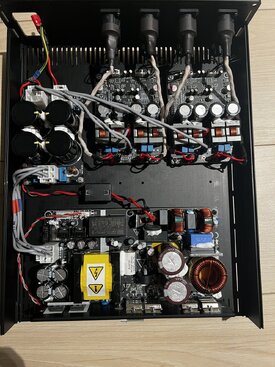

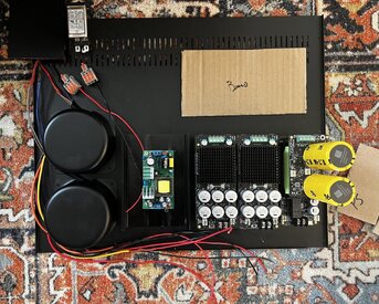

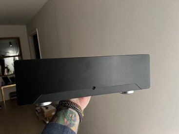

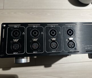

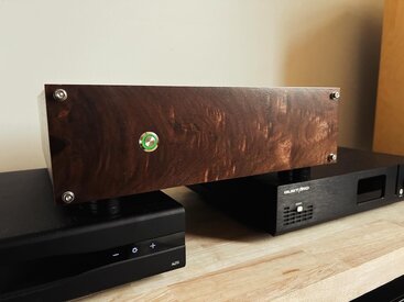

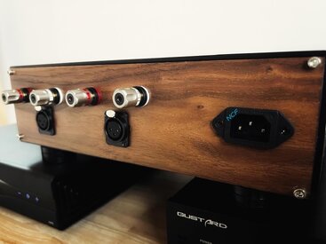

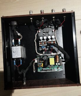

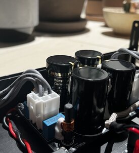

Just wanted to show off some amps I finished up building.
These use the 3e class d stereo modules with PFFB 2x260@4ohms.
They sound fantastic. Clear, precise, neutral. These are not fatiguing at all. Very class A/B sounding.
So far I’ve built a two channel for a friend and a 4 channel for myself that powers the mids and highs of my active 3way system.
All in cost was roughly $400 for the stereo build and $1000 for the 4 channel. (I splurged on power supply’s and extra caps)
Highly highly recommend this build.
