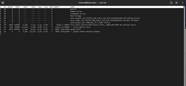

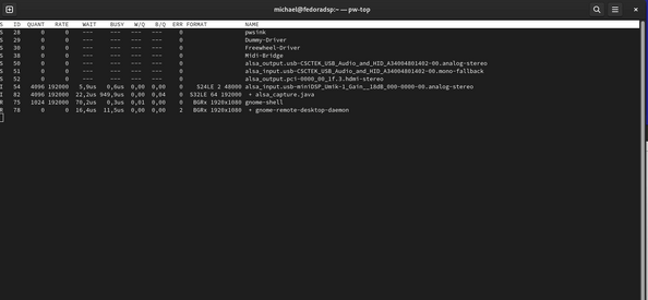

Initially, REW was not happy if I selected "default device" (which was the UMIK 1 in Gnome sound settings default device, which only uses pipewire when active), I got no input on SPL meter, so I pointed REW directly to the hardware plug device, which had no resampling apparently. With some magic dust, a reboot and a beer later, REW is working properly with "default device" (or "alsa_playback/capture.java" also, which I assume amounts to the same) on input, and do not care if I select 48kHz or 192kHz, as pipewire will handle the resampling (both input and output, have highest quality enabled). Have removed any custom alsa configurations. REW is still finicky with selecting UMIK 1 as default device at 192kHz, but it will work. REW often tries to fall back to plughw as input device instead of using "default device" during its UMIK 1 discovery. Will often give following error when doing so: (Edit: Dont press "Yes" when discovering Umik 1 during REW boot)
javax.sound.sampled.LineUnavailableException: U18dB [plughw:2,0] does not have any lines supporting PCM_SIGNED 192000.0 Hz, 24 bit, stereo, 6 bytes/frame, little-endian
Attached files are dumps from pw-top, showing its resampling the UMIK 1 (and I assume its pipewire and not ALSA doing that).
Unless you guys tell me otherwise, the only thing to do now, is to make sure that the (hopefully more or less) fixed time-delay in the measurements are corrected, so that phase-information is trustworthy. Which is a feature John already have in REW.
If you see something completely out of the ordinary let me know.
Kind regards Michael
