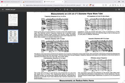

Why not IMD curves?
GOULAS
Oct 19, 2025
33
France

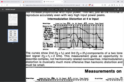

Log sweep measurements can only discriminate harmonic distortion. FSAF measurements can determine total distortion, which is mainly the sum of harmonic and intermodulation distortion. Stepped measurements allow a choice of various fixed frequency IMD measures vs signal level. The graph image you showed would require a sort of IMD sweep, a two tone signal with a fixed offset between the tones and suitably synchronised processing of the captured signal to extract the IMD components.
Thank you, Mr. John. Don't you find these curves interesting? Since they are old IMD curves, I thought it might be possible to reproduce them today. Instead of harmonic distortions, which aren't representative of transients, perhaps you could offer us these curves from a new program, based on the two tones? In my opinion, this is a lead worth exploring. You and REW would then be the first to present an updated measurement. Only you could do that!
