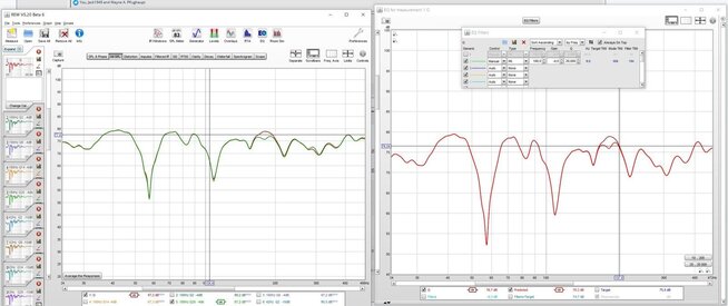

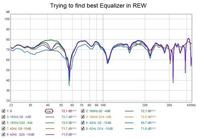

Ok, I tried to figure it out how to do that. I choose left speaker, set to large and put 4 filters at 180Hz peak with -4dB gain and did the same at 42 Hz peak with the same filters but with -10dB gain. (mdat file attached). Then I put the filters in one equalizer in REW and compare the predicted curve with the result. I concluded that "generic" works like a charm. Am I correct?
