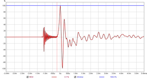

There is a strange feature in the REW IR from -1.1 ms to -0.2 ms, that is the source of increasing energy above 6.5 kHz. Not normally something one would see.
Your IRs are very short (too short) and truncated very close to the peak.

That strange feature between-1.1 to -0.2 you found in the IR I shot with REW or in the IR I did with my app and imported to REW? Do you have any idea what this could be? Can this come from noise (clicking), sometimes I have the feeling that the chirp has some noise within (slight clicking in the beginning and end)
7,337
The IR is used as guitar cab IR in a guitar modelling unit. Due to limited DSP power in real time and for the sake of acceptable latency those files are pretty short, 140ms is already a pretty long IR, most units use half (or even shorter).
OK, but you should window the IR to the required length after you have finished all the processing to extract it, don't truncate anything before that. You should be starting out with your sweep padded to twice its length with zeroes and the response captured to twice the sweep length.
With REW
Clicks or pops could cause that, if there are any you should try and find the cause and eliminate it. Make sure the ASIO buffer setting is long enough, 1k samples or more.
