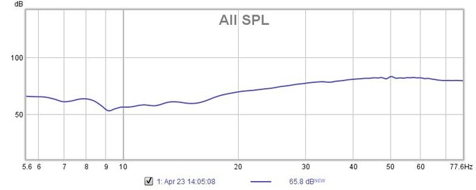

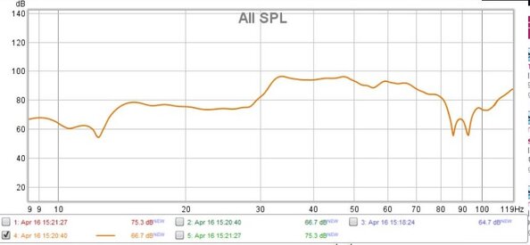

Hello,
Im having some trouble with my DIY Subwoofer's response and cannot for the life of me work out why my response would drop suddenly at 30hz and then 'level' out until my HPF kicks in at 15hz
the sub is 1 DIY Sealed 18" Dayton HO Driver in about 85-90L cabinet - Room is approx 1500 Cubic Ft
Please could you look and give me your thoughts? - this measurement was with no EQ applied
Many Thanks

Yes, please see attached, i took this measurement today
The scale of that graph is pretty huge, but the response is smooth so the previous measurement looks like the effect of room resonances. For graph scaling a 60 dB range is usually good, for example 45 dB at the bottom of the graph and 105 dB at the top. The Limits button at the top right of the graph lets you set those. Can also attach measurement mdat files.
Im sorry about that, I had the exact same thought after I made the graph but wasnt 100% on how to change it.
Anyhow, as taking measurements around the room would prove (attached), it is a room issue and cannot be sorted by moving the sub or the sofa within my limitations (makes virtually no difference to the large dip at 30hz).
So the question now would be regarding EQ, when I go to the EQ tab in REW and apply the filters to match target, it will not boost any frequencies lower than the target line, it will only cut the ones that are higher, is there any reason for this? Its a very heavy cut so Im reluctant to EQ this way.
I can manually move the filters but I cant help thinking Im missing something or have a setting wrong in the EQ somewhere

REW won't apply automatic boosts below the lowest frequency at which the response drops below the target to avoid the risk of pushing drivers beyond their limits. You can apply any low end boost you feel appropriate with manually entered filters though.
