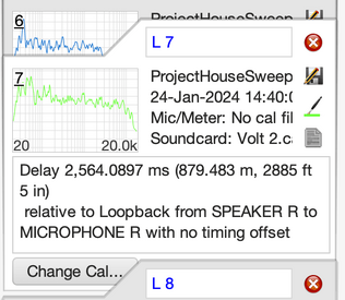

I recently used REW to measure a venue I work in using a sine sweep. I've attached the spectrogram of the reading taken at the mix position, which seems to seems to show she sweep arriving at around ~2.55s. I'm not sure why this is as this position is no more than 15m from the speakers. Is there anyway to offset the reading so that the sweep is shown to ocur closer to 0s, simply for ease of interpretation? Also if anyone knows how to avoid this happening in the future I'd be very appreciative of some enlightenment :)

Hi there. I was using UA VOLT2 interface with an earthworks measurement mic. I see now from the measurement dialogue that there it describes a delay. I didn't use a timing reference. I'm waiting on earthworks cal data, so hence no cal file, not that this should affect the subject in question?

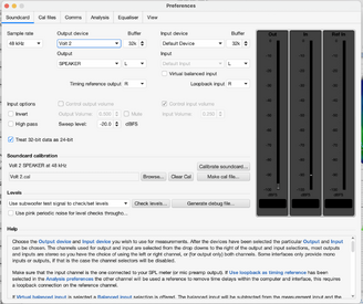

Soundcard preferences are on their way.

See here my souncard setup. Many thanks

From the measurement panel you posted you have selected a loopback timing reference. Try with No timing reference (as shown above) but if that causes issues with truncated measurements use the Acoustic timing reference.

That's great, I'll see if I can get in there again to try this. Otherwise I guess I can just subtract the stated delay time from the values on the plot.
Thanks so much for your help
7,337
You can use the Offset t=0 action on the Impulse graph to shift the plot, or the Set t=0 at cursor action.
