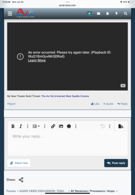

Found it on your YouTube channel but had a problem with the link here.
