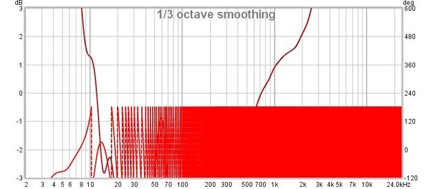

Just for kicks, I decided to try t& run the calibration on my laptop's built in sound card (Realtek) and basically got the same results. Using the onboard SC, there was an extra option in the levels tab to boost the microphone. If its set to 0 dB, I get the -70's plus reading I was getting with the Sound Blaster. I can boost it to 30 dB and get it in the -40's range.
So if I drop the sweep level to match the input level of the 30 dB boosted mic. Is the subsequent calibration file legit to use? So I know this graph would not make sense for an actual system RTA but I really don't know about a calibration result though it doesn't make sense to me but I have no reference. If it is legit, what is it telling me?

The cal efforts sound more like crosstalk pickup, are you definitely using the correct channel and a stereo cable for the loopback feeding a line input? Looks like the play 3 needs a 4-pole connector for the output side, not clear whether the input is mic/line or mic only.
Mic boost is for condenser mics, not line level connections.

Ok thanks, the cables I have and unfortunately the ones on the way are all 3 poles as I wasn't thinking about the loop back when I ordered them, rather connecting laptop or FLAC player to aux inputs, but a 4 pole connector makes sense for the mic connection point. Thanks again!
