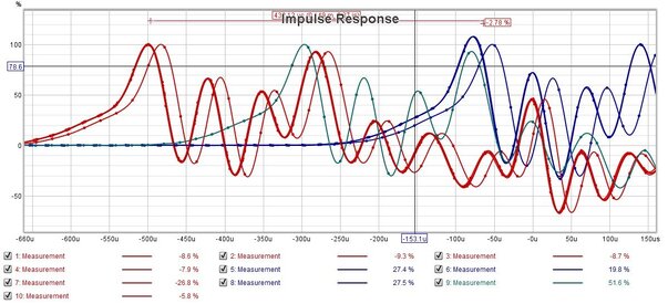

At my cluttered desk [5$ Mic flat on desktop and a little off-center under the monitor. Directional desktop speakers on rear corners and raised up 6 in.).
10 Measurements of right speaker using the left as the reference resulted in:
6 fell on top of each other (red, reference group)
3 fell ~0.4 ms more delayed (blue)
1 fell ~0.2 ms offset (green)
55903
55902
This is trivial for 80 Hz XO timing and marginal for a 200 Hz XO timing and no good at all above that.
I assume repeatability would be better in my AV area with cleaner direct sound to the mic but have never tested acoustic timing there. I normally use loopback timing.
This is just one quick data point.
Let us know what you get.
